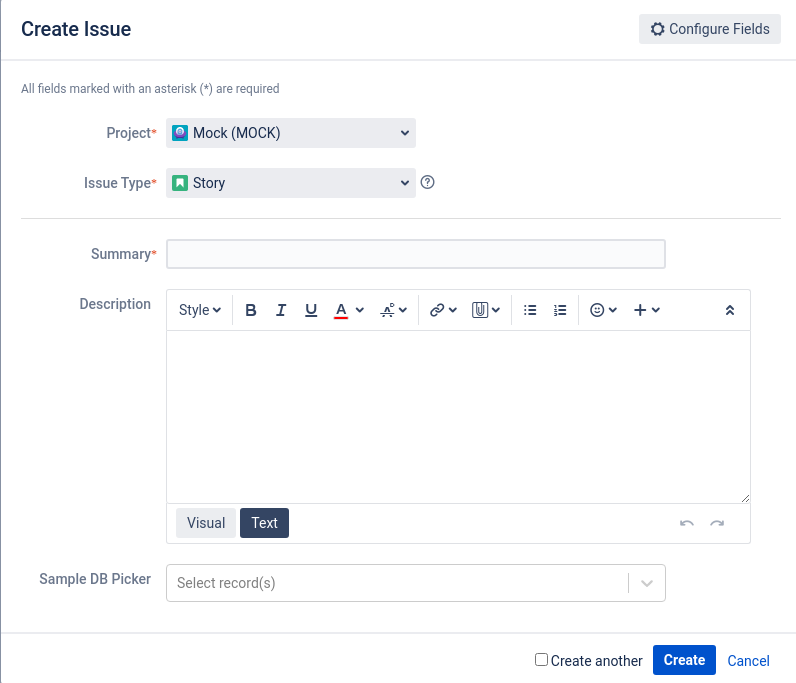

Below are some sample test screens for your reference:-
1) When the issue is first created, the DB Picker value is not set as shown below:-

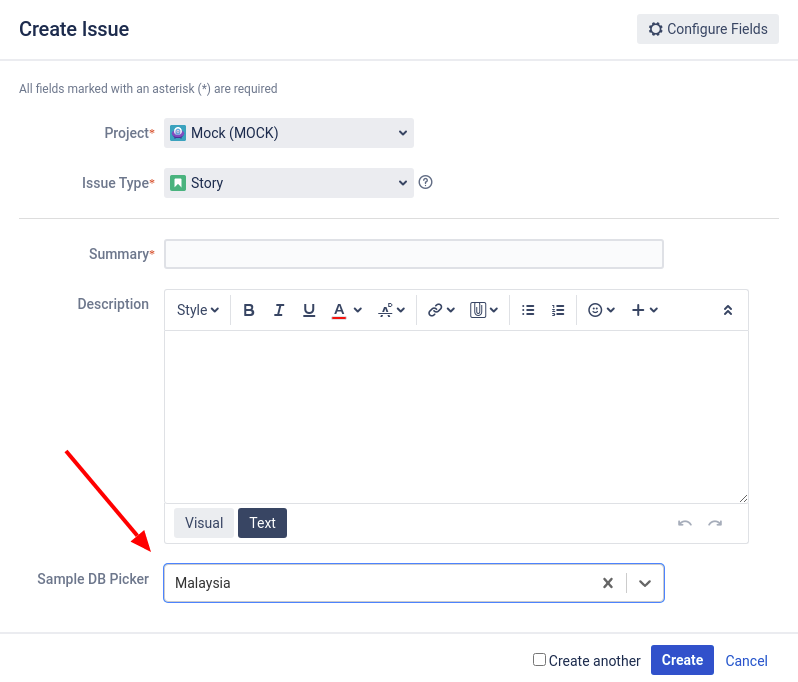

2) Once the option is selected from the DB Picker, as shown below, the value will be printed in the log as shown in the second screenshot below:-

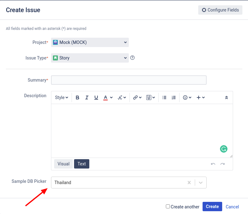

3) If the DB Picker option is updated as shown below:-
the log output will also update accordingly, as shown below:-

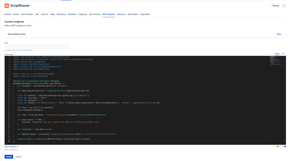

Below is the sample code for the REST Endpoint:-
import com.onresolve.scriptrunner.runner.rest.common.CustomEndpointDelegate
import groovy.json.JsonBuilder
import groovy.transform.BaseScript
import groovyx.net.http.HttpResponseDecorator
import groovyx.net.http.RESTClient
import javax.ws.rs.core.MultivaluedMap
import javax.ws.rs.core.Response
@BaseScript CustomEndpointDelegate delegate
getDBPickerValue { MultivaluedMap queryParams ->
def issueKey = queryParams.getFirst('issueKey')
def applicationProperties = ComponentAccessor.applicationProperties
final def baseUrl = applicationProperties.getString('jira.baseurl')
final def username = 'admin'
final def password = 'q'
final def headers = ['Authorization': "Basic ${"${username}:${password}".bytes.encodeBase64()}", 'Accept': 'application/json'] as Map
def http = new RESTClient(baseUrl)
http.setHeaders(headers)
def resp = http.get(path: "/rest/api/2/issue/${issueKey}") as HttpResponseDecorator
if (resp.status != 200) {
log.warn 'Commander did not respond with 200 for retrieving project list'
def issueJson = resp.data as Map
def dbPickerValue = issueJson['fields']['customfield_10800'] //Custom Field ID for DB Picker
Response.ok(new JsonBuilder(dbPickerValue).toPrettyString()).build()
Below is a screenshot of the REST Endpoint configuration:-

The REST Endpoint queries the issues by the issue key and extracts the value from the DB Picker field. The DB Picker field id is used to filter the REST result as shown in the code, i.e.:-
In my environment, the id for the DB Picker field is 10800; hence it is filtered with customfield_10800. You will need to modify this accordingly.
Once the result is filtered, the ID of the DB Picker will be returned by the REST Endpoint.
