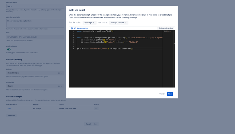

Below is a screenshot of the configuration:-
In the example above, only if Option1 is selected from Sample List will Sample List 2 be set to required. Else if any other option is selected from Sample List, Sample List 2 will not be required.

Below is a screenshot of the Behaviour configuration:-
For the sample case above, I am running the test on two single Select Lists, i.e. Sample List and Sample List 2.
Only if Option1 is selected from Sample List Sample List, 2 will be set to required. If any other option is selected from Sample List, Sample List 2 will not be set to required.
