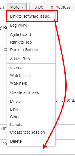

I have created a web-item located in operations-top-level. The menu text is longer than usual, and as a result is truncated (see linked screenshot).
Is it possible possible to display the whole menu text ?

I do not think that is possible, but maybe someone else has a different opinion. I think JIRA does this by itself. Maybe someone from Atlassian can be of more help.
Sorry!

Alright, I will find a workaround, thanks for your quick answer.
Another quick question : Is it possible to put the web-item at the bottom of the dropdown list and separate it with a line (same as the one separating "Create test session" and "Delete") ?

When you add a web item try to fill the weight field with 1000. The weight field influences the order.

I have tried a lot of different weights, but none is working. The web-item stays at the top.

This might have to do with the fact that they are different sections!
You can't move weight in between sections, only within the same div.
You might want to change the section, but I'm not sure we support every section in that sub-menu.

Thanks for your answer. I guess top will do fine. :)
