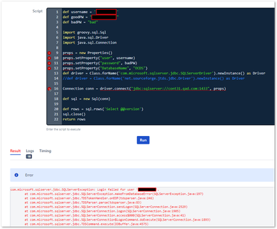

Let me add, that if you want to try the microsoft driver, the connection will look like this instead:
Connection conn = driver.connect("jdbc:jtds:sqlserver://df2v-catsql-p01.ebsi.corp:1433;domain=EBSI;useNTLMv2=true", props)
From your earlier logs, that driver appeared available and the correct one to use, but you appeared to supply a bad un/pw.
But I can't guarantee that it's something wrong with your installation. All I can say is that I don't understand why the driver would give you a login error if you are providing the correct login information.
I can replicate the error you displayed, both in the console and in resources when I put a bad password:
But when I use the correct password, I'm able to connect using both methods.

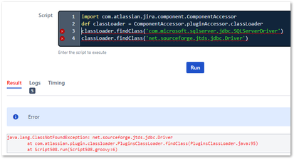

You can also use the console to test various classes to see which are actually available:
def classLoader = ComponentAccessor.pluginAccessor.classLoader
classLoader.findClass('com.microsoft.sqlserver.jdbc.SQLServerDriver')
classLoader.findClass('net.sourceforge.jtds.jdbc.Driver')
The error statement is clear, it cannot found the SQL Driver that you are using. You need to upload the driver to the <JIRA installation directory>/lib/ directory
