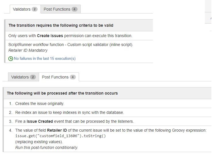

Rob B
February 1, 2018
Yes the same WF. Its a weird one the fact it works the first time, but then doesnt even though im doing exactly the same thing?
Below are the validators and post functions...

Rob B
February 1, 2018
Is there a chance it could be because one of the fields is a 'JSON Request Custom Field'?
