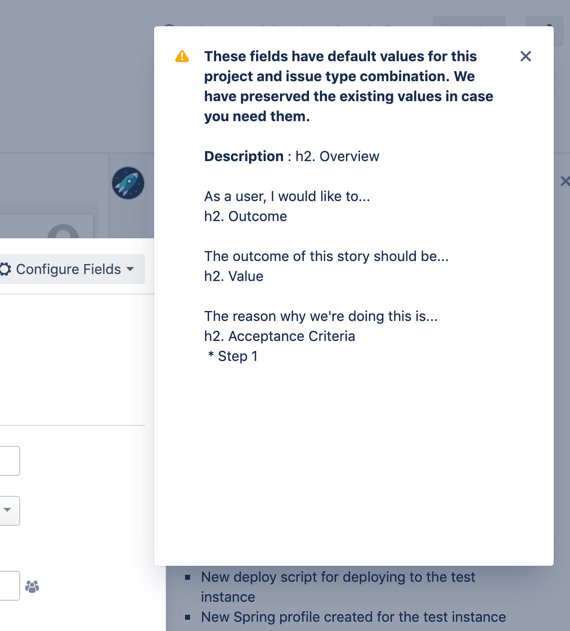

Hi @Thanos Batagiannis [Adaptavist] ,
What I'm noticing is that it works fine when viewing the create screen for the first time, but when I change the issueType I get the following error message:
My script is:

if (! underlyingIssue?.description && !desc.getValue()) {
desc.setFormValue(defaultValue)
Hi @Rafael Franco and welcome to community :P
This is intentional.
I don't remember exactly in which version we introduced it, but the reasoning behind it, is that if you have written something in a text area, and then make a change that will wipe out the text in that area, then show that kind of flag.
But we are open to suggestions.
Regards, Thanos
It's annoying if i am in the creation-process.
Please make it possible that one can get rid of the message.
I am in a creation-process. Depends on the issueType i set the description.
If one change the issueType then i would set a new description.
If one has changed the description manually i can evaluate it by myself and can desicde if i will overwrite it or not.
But if the description is the same as i set programmatically then i would like to change it without the message.
