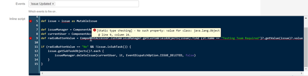

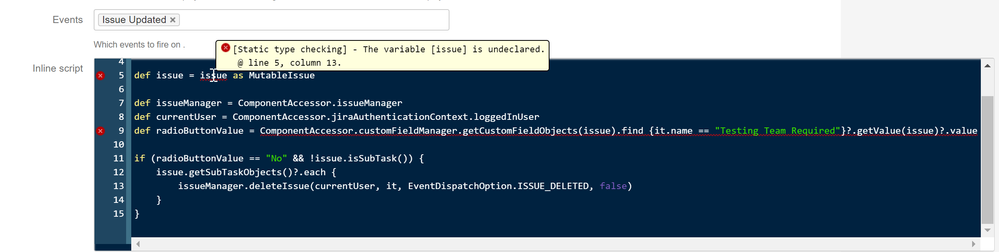

Hi Thanos,
I'm having a couple of issues with the code above, as it produces the following errors:
Is safe to ignore this error. Is because the issue variable is bound to the triggered event. The static type checking is not that clever :)
Give it a go ....
