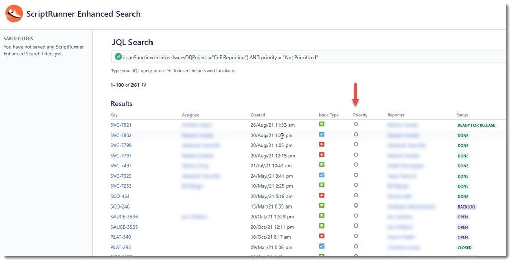

After some research we found the following script to use in ScriptRunner (does not work in Atlassian standard JQL query):
issueFunction in linkedIssuesOf(Project ="CoE Reporting") AND priority = "Not Prioritized"
We get the results below:
Now we just need to change the Priority of these results into a P2 via automation and/or bulk change.

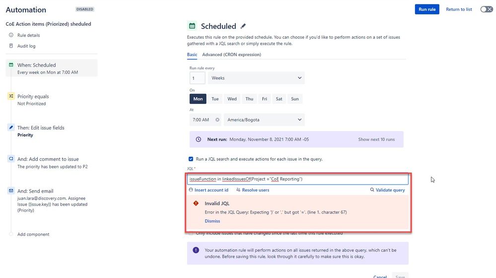

When attempting to use Jira automation it kicks it back as invalid.
When attempting to use standard issue filtering for bulk changing it kicks back the JQL as invalid

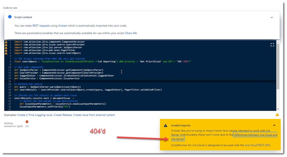

When looking at the Adaptavist library I got this possible solution to "Bulk Update the Value of a System Field on Jira Issues" but when I tried to use the script in the code on the automation it, too, returns errors because the script is apparently for Jira server, not cloud, but when I click on the link to learn more, I get a 404 error "page not found":

I can confirm that you are correct that you cannot use the issueFunction keyword in regular JQL search boxes directly such as on the automation screen.
However, I can confirm you can reference the saved search from the enhanced search page by calling its filter in order to use the issues returned by it in places such as Agile boards or automation rules and I can confirm we have a knowledge base article located here which explains this.
Finally, I can confirm the page the link you mentioned should link to is the page located here.

Hi Gregory,
I can confirm that we have now fixed the broken link on the Invalid imports popup and we thank you for bringing this to our attention and apologise for any inconvenience that this caused.
