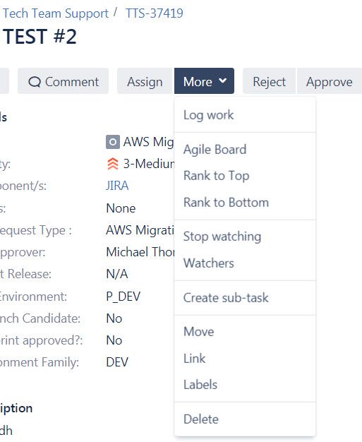

One of my projects contains a unique Issue Type called AWS Migrations. We create a parent issue and six sub-tasks underneath it for each software environment (QA, Pre-Prod, Practice, Production, and Demo).
I want to replace the Clone button with multiple scripts to Clone to P_PRE, Clone to P_PS, Clone to P_PRD, and Clone to P_DEM. This will allow me to create a custom clone script that also edits certain values in the master ticket that are important for each environment.

At any rate, I enabled both fragments and I successfully hid the original Clone option, but the new "Clone to P_PRE" option is missing.

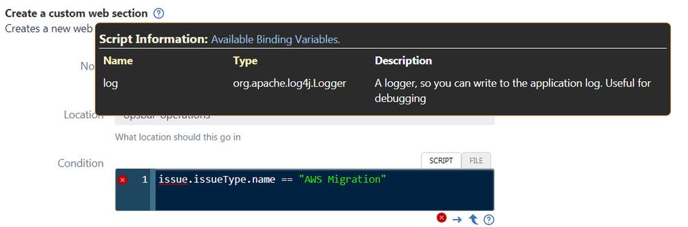

What kind of fragment are you using in the second case? Also, there's a (?) question mark button in the bottom right corner which shows which variables you can use without declaring to help you.
Michael Thompson
June 20, 2019
Hi Ilya,
In the second case, I am using "Create a custom web section".
I did click on the question mark, but the resulting information wasn't particularly useful (see screenshot). Nothing clickable, just a vague commentary.
