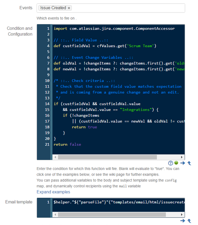

Issue Created
The issue created event that I set up looked like this:
IssueCreate.PNGI used this validation script:

and the following template reference:
$helper."${"parseFile"}"("templates/email/html/issuecreated.vm")

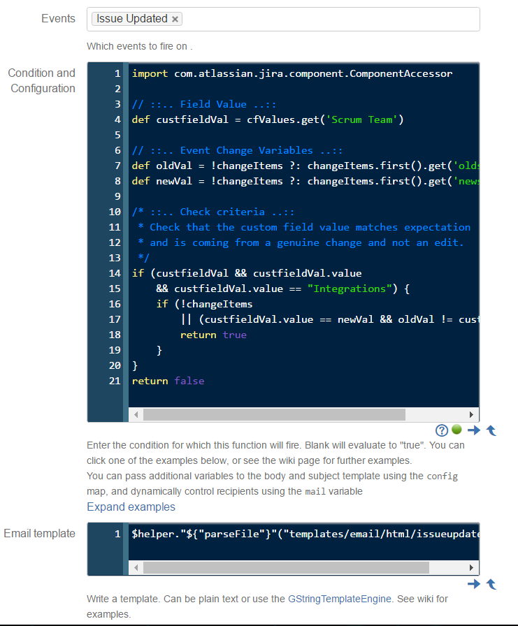

Issue Updated
The issue updated event that I set up looked like:
I used the same validation script as in create and I used the following template reference:
$helper."${"parseFile"}"("templates/email/html/issueupdated.vm")

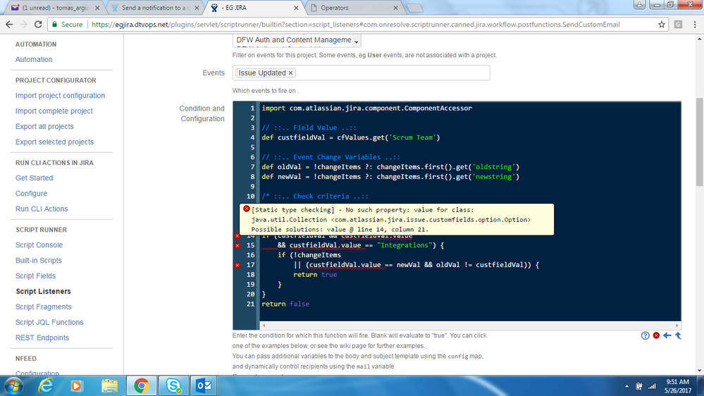

I am configuring the listener for the Issue Update event but I am getting some Static Type checking errors. I am attaching a picimage.png
Stephen Cheesley [Adaptavist]
May 30, 2017
Hi Tomas,
I had the same issue when I first added it, however, when I save and come back, those errors disappear.
