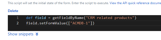

1. I set up a Behavior with the following code. Note that the value "ACMDB-1" has the Label "Catalyst" in Assets:

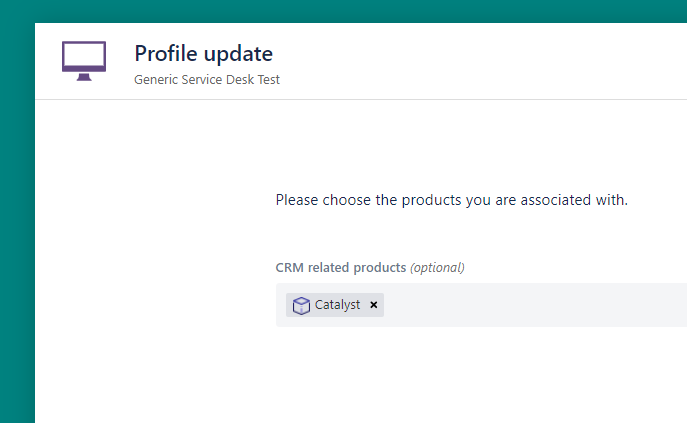

2. I created an Assets Custom Field with the following configuration (Select & Multiple):
3. The default is populated correctly when the Request screen is initialized:

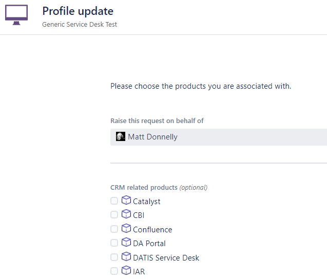

4. However, if I change the Assets custom field configuration to Checkbox...
5. The "Catalyst" checkbox is not checked:
