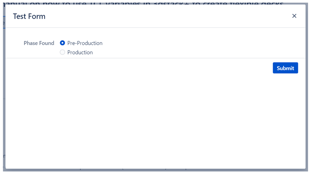

×I’m trying to implement a feature through ScriptRunner that involves extending the Jira “issue details” screen using a web fragment (a button), which in turn shows a dialog box with a form. For the purpose of demonstrating this issue, I have kept the implementation to a minimum (the form only contains a couple of Radio Buttons and a Submit button).
To summarize:

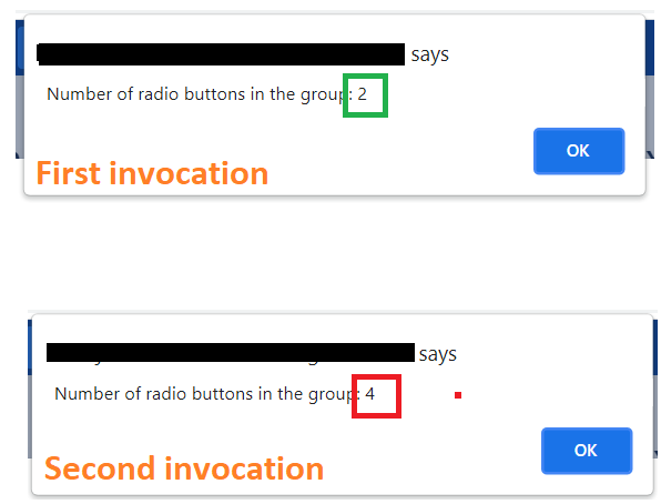

However, when I execute the following sequence, my JavaScript somehow thinks bumps up the radio button count by 2 upon every single invocation of this sequence.
Interestingly, if you refresh the web page after exiting the dialog, the dialog shows the correct number again, and both radio buttons are selectable.

It turns out that every time you click the button, your dialog html is embedded into the DOM and when you close it, the html is still in there.
Every time you click the button, you get another copy in the DOM.
You can avoid this by adding the data-aui-remove-on-hide attribute to the section tag
<section id="static-dialog" class="aui-dialog2 aui-dialog2-large" role="dialog" data-aui-remove-on-hide="true">
