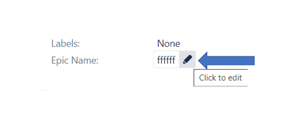

Good Day
Hi community i am struck at certain thing and iam not able to figure out the  name of  module key for the web element  in the Jira instance as pointed(edit Button )  . Hope somebody can help me out here
Below Picture for Reference
PD Sheehan
May 4, 2021
I don't think there is a web module associated with a single field.
What is your end goal? Maybe we can help you achieve that.
acc1211
May 5, 2021
thank you peter for the answer i have made an extensive research and found out that there is nothing as such web module for it .
My main problem is whenever i am using my jira instance from the mobile app . the script runner behaviors functionality is not working which helps in stopping the inline edit for different fields . If you happen to know anything in this regards ,can you please help me or direct in that way   . @PD Sheehan
PD Sheehan
May 5, 2021
Scriptrunner behaviour will have no effect on the mobile app. I would not expect that to ever change.
If you want to prevent in-line edit in the mobile app, I suspect you would need to remove the field in question from the edit screen.
But then, you need a way for users to set/change it in the desired controlled way (with behaviour), so you would have to create a special transition in your workflow linked to a screen that contains that field. In that workflow transition context, then your behaviour logic will work.
