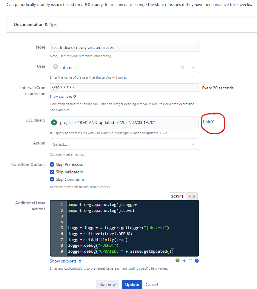

Alright so I have no idea what is going on, but something isn't working still.
This Escalation Job should at all times find 1 issue, and it does if I execute it, but not when it runs on its own:
