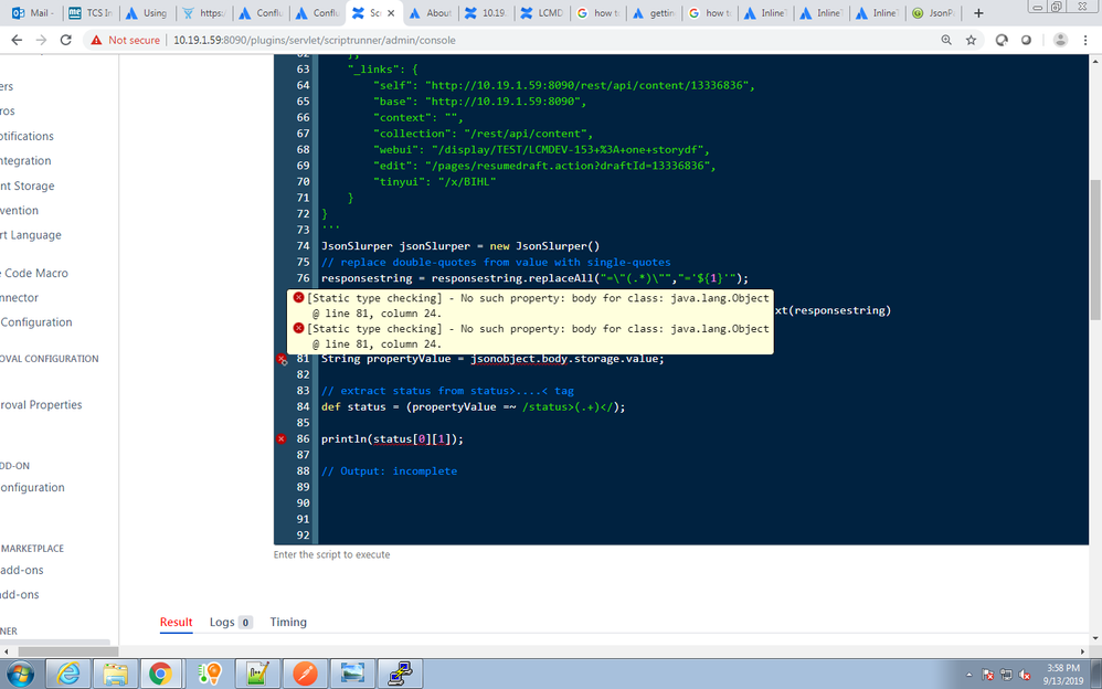

Sushma September 13, 2019
Thanks alot @Rafael Pinto Sperafico
I will try with the above code..
Regards
Sushma
Hi @Rafael Pinto Sperafico
I changed to
String propertyValue = jsonobject.getAt("body").getAt("storage").getAt("value")
Thank you
Kind Regards
Sushma

def webUrl = new JsonSlurper().parseText(response.responseBodyAsString)["_links"]["webui"]

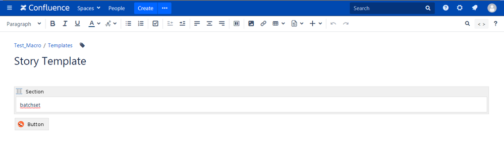

My template format is as shown below
template structure.PNG here what i am doing is I am replacing the "batchset" value with the "body" which is received from Jira.
Using the above code I am successfully able create a page in confluence.
