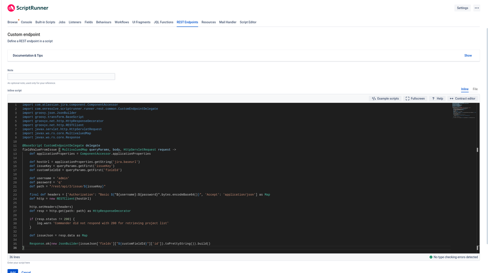

You need to first make a REST Endpoint to invoke the issue in which the Multi-User picker is added and filter the custom field, i.e. something like this:-

Below is a screenshot of the REST Endpoint configuration:-

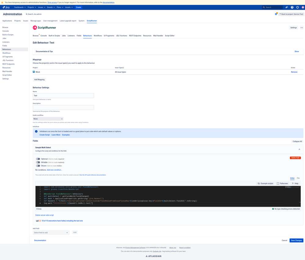

Below is a screenshot of the Server-Side Behaviour configuration:-
Please note that the sample working codes above are not 100% exact to your environment. Hence, you will need to make the required modifications.
If you observe the Server-Side Behaviour code above, it is pulling the data from the REST Endpoint for the Multi-Select field that is added to this issue.
Please note that this cannot be done on the create screen. It can only be done after the issue has been created, i.e. either on an Edit screen or a Transition screen.
