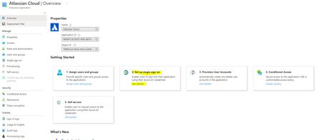

It will take a couple of minutes to create the new application. Once it’s finished it will take you to the Atlassian Cloud application overview page. From here, we want to click on the “Get started“ link for “2. Set up single sign on“
