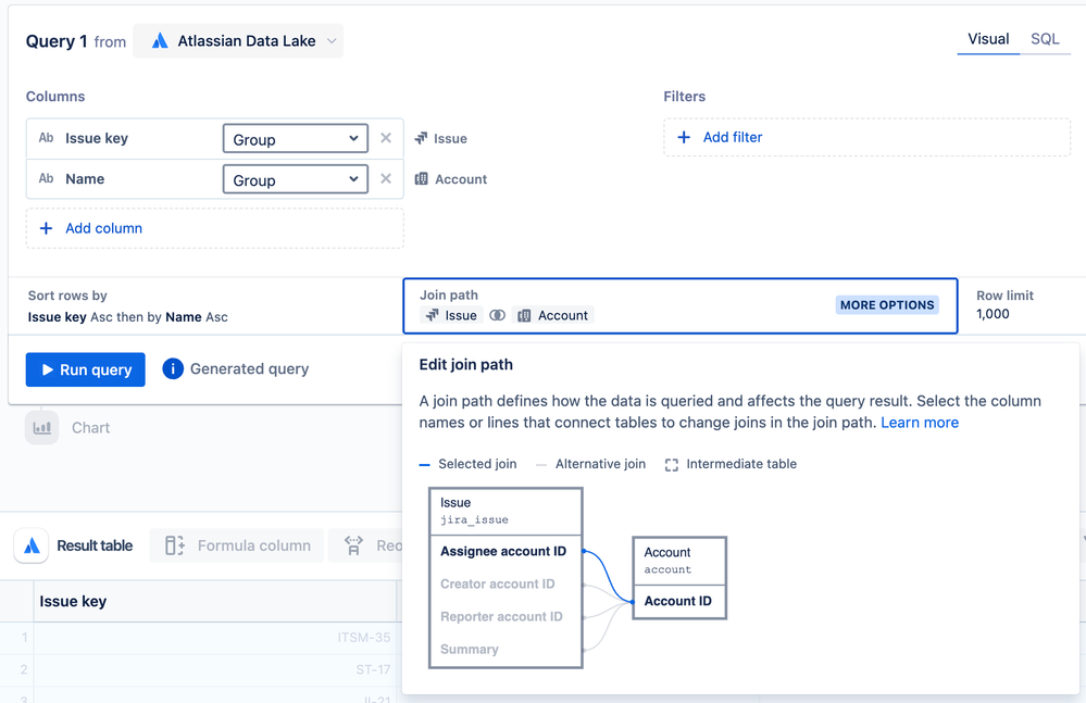

Hi Andrew! Could you check that the join path is using the Assignee account ID column to connect the Issue and Account tables? The path highlighted in blue is the current join path used by the query.
It's possible that your query may be using the Creator or Reporter account ID instead, which could explain the incorrect names. If an incorrect join path is used, just click on the line using the Assignee account ID column to connect the two tables and re-run the query to help the join path update.
If the query is using the Assignee account ID column in the join path, you can create a support ticket with our team to help us troubleshoot further.
