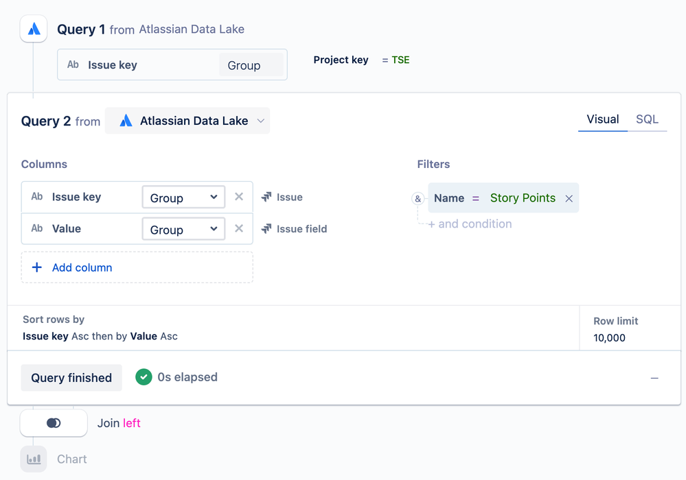

This can also be done by merging two Visual mode queries together. You can select the columns and filters and then change the join type to 'left'.
After getting the query results (in either SQL mode or Visual mode) which would be a list of all issue keys and their custom field values, you can use a "Group & aggregate" step to then get a count of distinct issues.
To replace the null values with text such as "this is not populated for this issue", you can then apply a case statement using an "Apply formula" step on the Value column.
