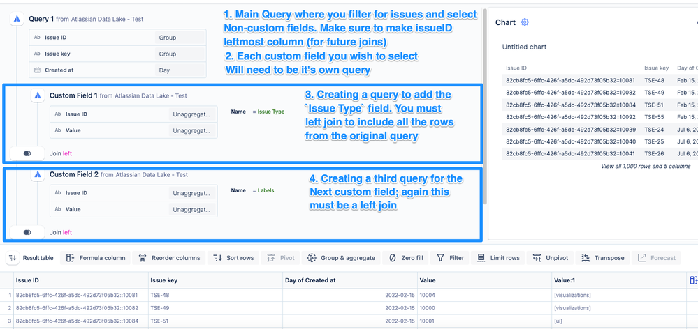

The trick is that each custom field you wish to add to your result set, will need to be it's own query. You can add additional queries to your main query and then choose the join type.
Here is a quick example of how you could add to custom fields to your main result set:
Hope this helps!

ooohh I was so close, was trying to do that exact thing but in the one query which obviously wasn't going to happen.
Thanks for that, makes sense now that I see it and have mocked one out myself.

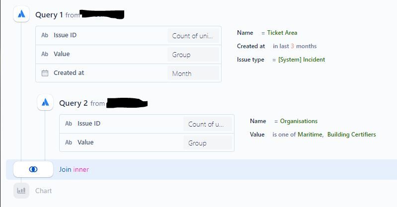

One question.  I have this basic query that produces a bar chart, simple enough.
I have a custom field called ContractOrgs and I want to filter these results to only be three of these specific companies in the list, where do I put the name and value option for that field in this chart setup.graph.JPG

Thanks for the answer, but I am coming up empty.
If I run query 1 by itself, I get data.  If I run query 2 by itself I get data, running it as a whole chart, nada.  If I change query 2 to be unaggregated I get no data when combined.Chart2.JPG
What have I mucked up?   (also using the Organisations field but still not getting expected output)

June 1, 2023
Hey Steven,
In both queries Issue ID would have to be unaggregated because you need both queries to return the issue id's themselves so that you can join on them.
If you want to get counts, you can add a Group & Aggregation step at the end of everything else.

Matthew Lempitsky
June 2, 2023
Hi Steven,
This is occurring because you have selected unaggregated for Issue ID but have selected group as the aggregation for "value", those columns will also need to be unaggregated.
