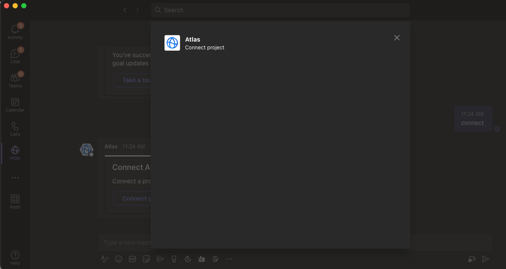

- Modal showing the projects has no projects in it to connect to
- In the browser client, I can see a 404 not found error for the iframe inside the modal

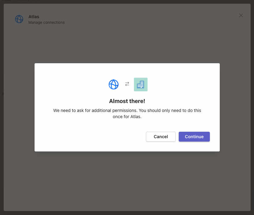

Would you be so kind as to confirm if the permissions you mentioned looked like this?
These permissions are on behalf of the user. When you grant them, the dialogs start working properly.
Yes, I'm at this step. Still waiting on my Microsoft admin to approve it, so no updates for the community today, probably by the end of the week.
Hi @GBallard, thanks for confirming! While we're waiting on your admins, mind sharing a screenshot or screen recoding of what you're seeing when you try to subscribe to a project? It'll help us smooth out the experience in the future

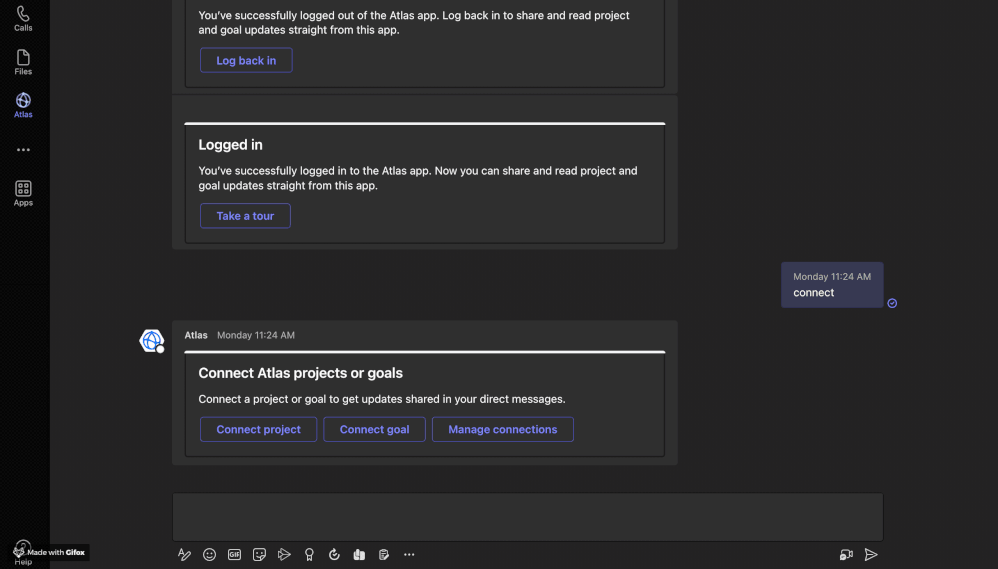

After logging in to Atlassian, this is how it looks.
I stop right before logging in to Microsoft and actually make a request from that window that pops up.
Hi @GBallard, thanks for your recording. This is expected behavior that you need to authenticate to Microsoft. It will grant the necessary permissions to the dialogs.
What happens after you log in? You should see the dialog's content.

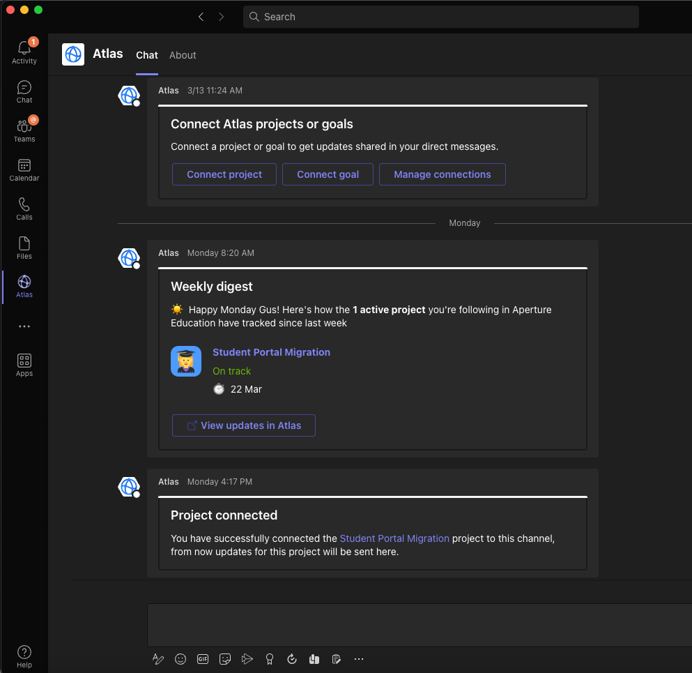

FYI, for others reading this: while in Slack you are able to connect projects to specific channels, in MS Teams you can only get updates on the Atlas window/tab (as is shown on the screenshot below) instead of connecting to specific Team Channels, so each person needs to set this up for themselves.
We actually support connection to Team channels too!

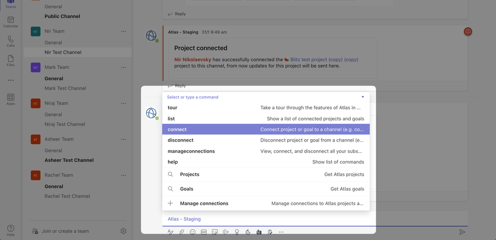

1. Go to your channel of choice
2. Type @Atlas in the chat
3. You have a few options here -> type connect, click on connect in the command drop down, or click on manage connections - all should allow you to connect a project to a channel (see screenshot)
That's great! I had no idea you could do that. Just tested it, thanks.
