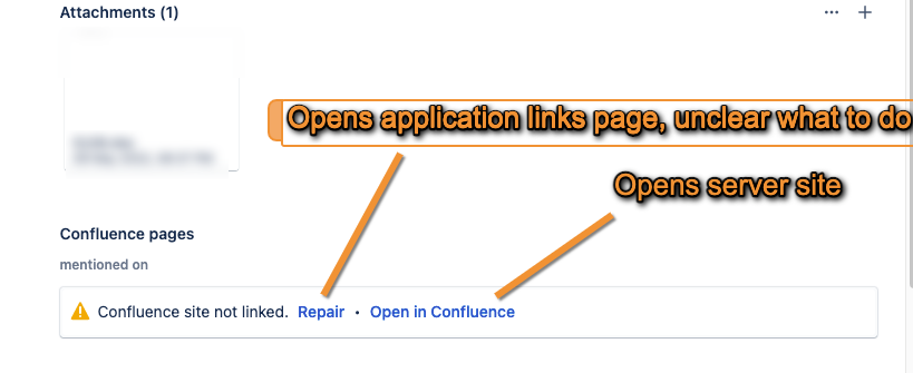

After a successful server to cloud migration, I am getting the error below.  Jira macro repair did not fix this.
I did not see anything about this in the migration documentation.  Is this a common issue?  How can this be addressed?

Hi @Rob Horan ,
Some links between Jira and Confluence are not migrated correctly.
You have to ask Atlassian support to fix this (via a MOVE ticket).
This is a known issue. It will only repaired by Atlassian support when you migrate to production.
I wish you good luck with the migration journey.

Would that be what's in this article?
https://confluence.atlassian.com/confkb/after-a-successful-server-to-cloud-migration-url-links-are-broken-in-the-new-cloud-instance-1077781093.html
I found this after posting here.
I am hoping the team I am working with will be OK with waiting until the production migration is complete before fixing it.
Is this a common problem?  Shouldn't this article be linked to the JCMA/CCMA documentation?
Erik Mathijs
May 17, 2022
Indeed @Rob Horan
I have the same problem and communicated with Atlassian support.
They promised me the link fixing will be done after production migration.
While mentioned in the article that this is a very time-consuming and manual task, i also hope that it does not disturb my teams working in Jira and confluence.
