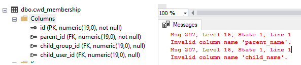

You were right about permissions.  Now oddly I am able to get info from Jira, but am unable to run the group query on Confluence:
SELECT DISTINCT parent_name AS groupname, child_name AS username FROM cwd_membership;
Msg 207, Level 16, State 1, Line 1
Invalid column name 'parent_name'.
Invalid column name 'child_name'.
Looking at dbo.cwd_membership, I don't see those column names... so in that sense the error makes sense, but then Atlassian's documentation doesn't.

Phill Fox
May 20, 2021
Hi @Rob Horan
Ah yes the delights of the confluence database structure.
If you have not found it already the page https://confluence.atlassian.com/doc/confluence-data-model-127369837.html is super useful especially if you match it to your version of Confluence.
Using the SQL on https://support.atlassian.com/migration/docs/confluence-pre-migration-checklist/ for checking the user cloud limit as a starting point
SELECT u.lower_user_name, d.directory_name, g.group_name FROM cwd_user u JOIN cwd_membership m ON u.id = child_user_id JOIN cwd_group g ON m.parent_id = g.id JOIN SPACEPERMISSIONS sp ON g.group_name = sp.PERMGROUPNAME JOIN cwd_directory d on u.directory_id = d.id WHERE sp.PERMTYPE='USECONFLUENCE' AND u.active = 'T' AND d.active = 'T' GROUP BY u.lower_user_name, d.directory_name ORDER BY d.directory_name;
You should be able to manipulate this SQL to get the information you require from Confluence.
