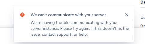

Hi ,
We are using confluence migration assistant app to migrate confluence form server to cloud & getting the below error while we try to initiate a migration. Any idea why this could be coming?
This is happening since we have upgrade our confluence to 7.4.1 recently. Please help

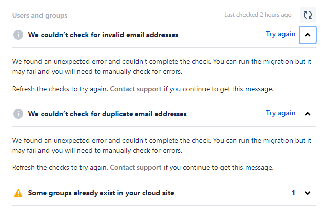

I have the exact same error in the pre-check of a Confluence migration:
2022-02-28 15_49_33-EnBW_Jump-Host - VMware Workstation 15 Player (Non-commercial use only).png

I appear to have such errors/warnings in my logs:

 The Error trace starts with this:
2022-02-28 16:11:20,290 WARN [http-nio-443-exec-16] [v2.c3p0.impl.NewPooledConnection] log [c3p0] A PooledConnection that has already signalled a Connection error is still in use!
-- referer: https://confluence.energybase.com/admin/migration.action | url: /rest/migration/latest/stats/usersGroups | traceId: b36cbd0e5ee119bd | userName: konstantin.weber@sva.de
2022-02-28 16:11:20,292 WARN [http-nio-443-exec-16] [v2.c3p0.impl.NewPooledConnection] log [c3p0] Another error has occurred [ com.mysql.jdbc.exceptions.jdbc4.MySQLNonTransientConnectionException: No operations allowed after connection closed. ] which will not be reported to listeners!
Konstantin Weber - SVA February 28, 2022
Adding "&autoReconnect=true" to the jdbc-connection string solved the problem.
