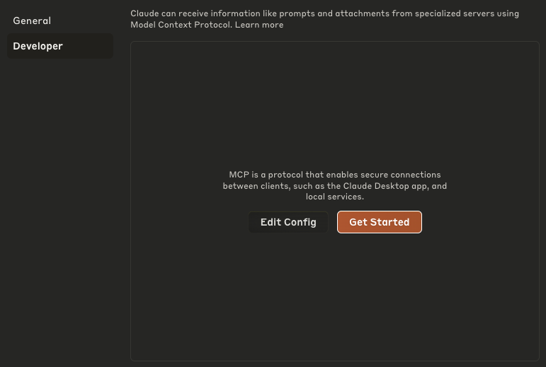

Take Claude Desktop as an example, you can find its MCP configuration file from the "Developer" tab in its settings dialog.
To setup connection to the Atlassian Remote MCP Server beta, you can use the following configuration -

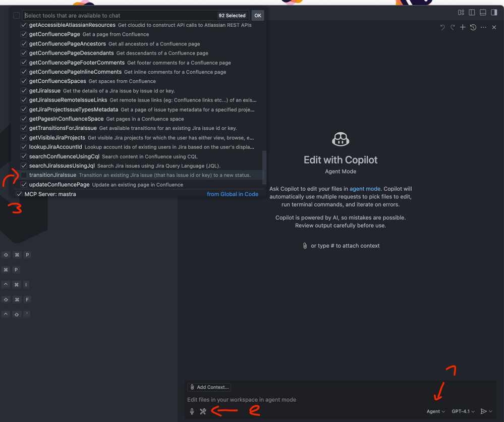

It works now in VS Code, but one tool is causing issues : TransitionJiraIssue. When enabled, I get this in Insider:
Failed to validate tool bb7_transitionJiraIssue: Error: tool parameters array type must have items. Please open a Github issue for the MCP server or extension which provides this tool

Richard Boisvert
May 21, 2025
@Robert Bradford you can just unselect the tool (shift + command + 6 on mac) and it works after, but it is still selected when you exit/reopen VS Code.

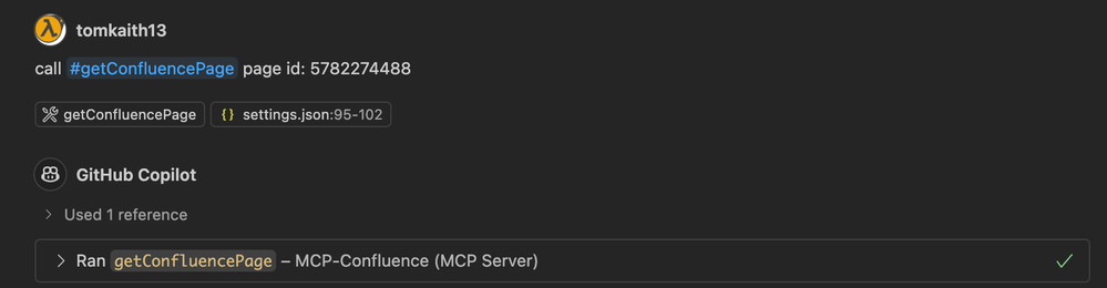

I'm seeing the same issue others are seeing when trying to use this MCP server in VS Code. When I issue a general query I see the following error:
And, when I issue a query like: "call #getConfluencePage 12345" as shown in other comments above, the input is:
"cloudId": "your-cloud-id",
"pageId": "12345"
and the error I see is:
{"error":true,"message":"Cloud id: your-cloud-id isn't explicitly granted by the user."}
It looks like the cloudId is not being set correctly for my MCP server requests. Should this cloudId be set as a part of the mcp-remote operation that performs authentication? Or is this something I need to set manually in my VS Code config (or elsewhere)?

Manuel Göster
May 22, 2025
I resolved the bb7_transitionJiraIssue by disabling only this tools. Then you can use all other MCP tools. Looks like it is malconfigured on the atlassian MCP server side!
To disable it, use the Tool icon in your copilot chat window, find it in the list of tools and deselect it.Screenshot 2025-05-23 at 08.35.10.png
