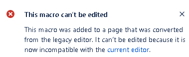

I just wanted to share my experience so far converting a table from the old editor to new editor in Confluence, I needed to do it because of requirement Yogi:
After converting, I get the following message:
Within the macro is a table which I need to copy out to fix this Problem.

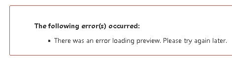

Sigh I knew it, well alright next try, let's see the preview after copying the table:
I have a suspicion, that trying it later will resolve nothing. So, let's restart with a new plan:
I could:
  1. Copy the requirement yogi part out of the Table
  2. Transform the page but leave an old Preview open
  3. Copy the old Table and remove the transformed one
  4. Copy the transformed requirement yogi part in the copy of the old table
It actually worked, the page status doesn't work anymore but the table exists can be edited and requirement yogi works.
