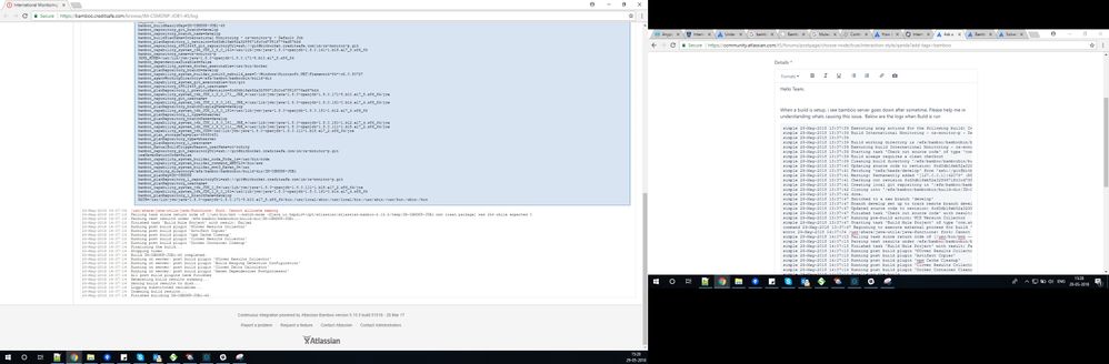

When a build is setup, i see bamboo server goes down after sometime. Please help me in understanding whats causing this issue.  Below are the logs when Build is run
Let me know if you need more information

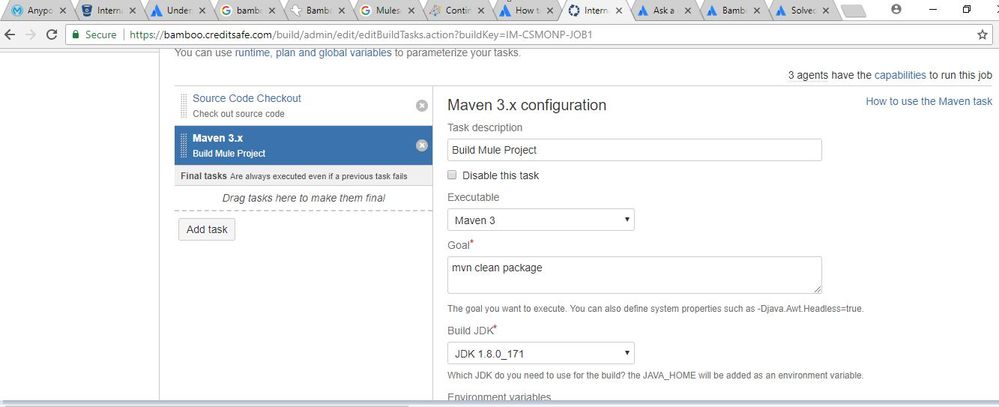

simple 29-May-2018 13:37:47 Starting task 'Build Mule Project' of type 'com.atlassian.bamboo.plugins.maven:task.builder.mvn3'
command 29-May-2018 13:37:47 Beginning to execute external process for build 'International Monitoring - cs-monitor-p - Default Job #45 (IM-CSMONP-JOB1-45)'\n ... running command line: \n/usr/bin/mvn --batch-mode -Djava.io.tmpdir=/opt/atlassian/atlassian-bamboo-5.15.5/temp/IM-CSMONP-JOB1 mvn clean package\n ... in: /efs/bamboo/bamboobin/build-dir/IM-CSMONP-JOB1\n ... using extra environment variables: \nbamboo_planRepository_1_branch=develop\nbamboo_capability_system_builder_nunit3_NUnit_3_Build=C:\Windows\Microsoft.NET\Framework*64*\v2.0.50727\msbuild.exe\nbamboo_repository_49512449_branch_name=develop\nbamboo_planRepository_1_branchDisplayName=develop\nbamboo_repository_revision_number=6cd3db16eb52a3299671fc0cd79516776ed87b2d\nMAVEN2_HOME=/usr\nbamboo_resultsUrl=https://bamboo.creditsafe.com/browse/IM-CSMONP-JOB1-45\nbamboo_planRepository_1_name=cs-monitor-p\nbamboo_build_working_directory=/efs/bamboo/bamboobin/build-dir/IM-CSMONP-JOB1\nbamboo_buildKey=IM-CSMONP-JOB1\nbamboo_capability_system_jdk_JDK_1_8_0_171=/usr/lib/jvm/java-1.8.0-openjdk-1.8.0.171-8.b10.el7_5.x86_64\nbamboo_repository_49512449_name=cs-monitor-p\nbamboo_shortPlanName=cs-monitor-p\nbamboo_planRepository_name=cs-monitor-p\nbamboo_buildNumber=45\nbamboo_capability_system_jdk_JDK_1_8_0_131=/usr/lib/jvm/java-1.8.0-openjdk-1.8.0.131-2.b11.el7_3.x86_64\nbamboo_shortJobName=Default Job\nbamboo_buildResultsUrl=https://bamboo.creditsafe.com/browse/IM-CSMONP-JOB1-45\nbamboo_capability_system_builder_nunit3_MSBuild_Run=C:\Program Files (x86)\MSBuild\14.0\bin\MSBuild.exe\nbamboo_planRepository_repositoryUrl=ssh://git@bitbucket.creditsafe.com/im/cs-monitor-p.git\nbamboo_capability_system_jdk_JDK_1_8_0_121__JRE_=/usr/lib/jvm/java-1.8.0-openjdk-1.8.0.121-0.b13.el7_3.x86_64/jre\nbamboo_agentId=53084161\nbamboo_planName=International Monitoring - cs-monitor-p\nbamboo_shortPlanKey=CSMONP\nbamboo_repository_49512449_previous_revision_number=6cd3db16eb52a3299671fc0cd79516776ed87b2d\nbamboo_shortJobKey=JOB1\nbamboo_repository_49512449_git_branch=develop\nbamboo_planRepository_revision=6cd3db16eb52a3299671fc0cd79516776ed87b2d\nbamboo_repository_previous_revision_number=6cd3db16eb52a3299671fc0cd79516776ed87b2d\nbamboo_buildTimeStamp=2018-05-29T13:37:39.638Z\nbamboo_planRepository_previousRevision=6cd3db16eb52a3299671fc0cd79516776ed87b2d\nbamboo_repository_49512449_revision_number=6cd3db16eb52a3299671fc0cd79516776ed87b2d\nM2_HOME=/usr\nbamboo_buildResultKey=IM-CSMONP-JOB1-45\nbamboo_repository_git_branch=develop\nbamboo_repository_branch_name=develop\nbamboo_buildPlanName=International Monitoring - cs-monitor-p - Default Job\nbamboo_planRepository_1_revision=6cd3db16eb52a3299671fc0cd79516776ed87b2d\nbamboo_repository_49512449_git_repositoryUrl=ssh://git@bitbucket.creditsafe.com/im/cs-monitor-p.git\nbamboo_capability_system_jdk_JDK_1_8_0_141=/usr/lib/jvm/java-1.8.0-openjdk-1.8.0.141-1.b16.el7_3.x86_64\nbamboo_repository_name=cs-monitor-p\nJAVA_HOME=/usr/lib/jvm/java-1.8.0-openjdk-1.8.0.171-8.b10.el7_5.x86_64\nbamboo_dependenciesDisabled=false\nbamboo_capability_system_docker_executable=/usr/bin/docker\nbamboo_planRepository_branch=develop\nbamboo_capability_system_builder_nunit3_msbuild_exe=C:\Windows\Microsoft.NET\Framework*64*\v2.0.50727\nbamboo_agentWorkingDirectory=/efs/bamboo/bamboobin/build-dir\nbamboo_capability_system_git_executable=/bin/git\nbamboo_repository_49512449_git_username=\nbamboo_planRepository_1_previousRevision=6cd3db16eb52a3299671fc0cd79516776ed87b2d\nbamboo_capability_system_jdk_JDK_1_8_0_171__JRE_=/usr/lib/jvm/java-1.8.0-openjdk-1.8.0.171-8.b10.el7_5.x86_64/jre\nbamboo_repository_git_username=\nbamboo_capability_system_jdk_JDK_1_8_0_161__JRE_=/usr/lib/jvm/java-1.8.0-openjdk-1.8.0.161-0.b14.el7_4.x86_64/jre\nbamboo_planRepository_branchDisplayName=develop\nbamboo_capability_system_jdk_JDK_1_8_0_151=/usr/lib/jvm/java-1.8.0-openjdk-1.8.0.151-1.b12.el7_4.x86_64\nbamboo_planRepository_1_type=bbserver\nbamboo_planRepository_branchName=develop\nbamboo_capability_system_jdk_JDK_1_8_0_151__JRE_=/usr/lib/jvm/java-1.8.0-openjdk-1.8.0.151-1.b12.el7_4.x86_64/jre\nbamboo_capability_system_jdk_JDK_1_8_0_111__JRE_=/usr/lib/jvm/java-1.8.0-openjdk-1.8.0.111-1.b15.el7_2.x86_64/jre\nbamboo_capability_system_jdk_JDK=/usr/lib/jvm/java-1.8.0-openjdk-1.8.0.111-1.b15.el7_2.x86_64/jre\nbamboo_plan_storageTag=plan-48660481\nbamboo_planRepository_type=bbserver\nbamboo_planRepository_1_username=\nbamboo_ManualBuildTriggerReason_userName=oc-rohity\nbamboo_repository_git_repositoryUrl=ssh://git@bitbucket.creditsafe.com/im/cs-monitor-p.git\nuseMavenReturnCode=false\nbamboo_capability_system_builder_node_Node_js=/usr/bin/node\nbamboo_capability_system_builder_command_AWSCLI=/bin/aws\nbamboo_capability_system_builder_mvn3_Maven_3=/usr\nbamboo_working_directory=/efs/bamboo/bamboobin/build-dir/IM-CSMONP-JOB1\nbamboo_planKey=IM-CSMONP\nbamboo_planRepository_1_repositoryUrl=ssh://git@bitbucket.creditsafe.com/im/cs-monitor-p.git\nbamboo_planRepository_username=\nbamboo_capability_system_jdk_JDK_1_8=/usr/lib/jvm/java-1.8.0-openjdk-1.8.0.111-1.b15.el7_2.x86_64/jre\nbamboo_capability_system_jdk_JDK_1_8_0_161=/usr/lib/jvm/java-1.8.0-openjdk-1.8.0.161-0.b14.el7_4.x86_64\nbamboo_planRepository_1_branchName=develop\nPATH=/usr/lib/jvm/java-1.8.0-openjdk-1.8.0.171-8.b10.el7_5.x86_64/bin:/usr/local/sbin:/usr/local/bin:/usr/sbin:/usr/bin:/sbin:/bin\n
error 29-May-2018 14:07:04 /usr/share/java-utils/java-functions: fork: Cannot allocate memory
simple 29-May-2018 14:07:13 Failing task since return code of [/usr/bin/mvn --batch-mode -Djava.io.tmpdir=/opt/atlassian/atlassian-bamboo-5.15.5/temp/IM-CSMONP-JOB1 mvn clean package] was 254 while expected 0
