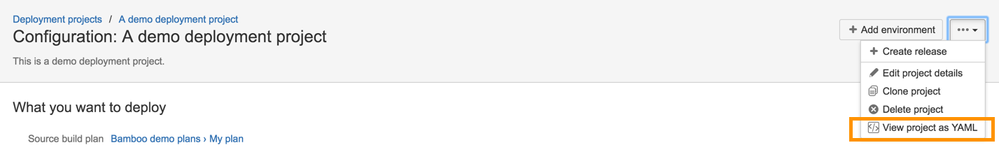

note: according to this https://confluence.atlassian.com/bamboo/creating-and-configuring-a-deployment-project-338363448.html there should be some form of YAML support already (last updated Jan 2018), but this does not exist in 6.5?
Bamboo instance administrators can view the deployment configuration in the YAML format in Deployment project configuration > Actions:

@Jules Clements - the documentation has not been updated it seems, insofar this has been a preliminary YAML export feature that existed before the introduction of Bamboo Specs and has since been replaced by 'View project as Bamboo Specs', which only supports Bamboo Specs (Java) at this point though.
