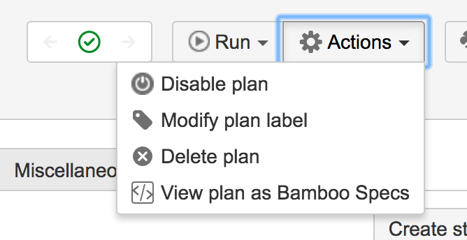

try to go other way around. create plan with CVS repository and then go to Plan configuration and choose "View plan as Bamboo Spec"Screen Shot 2017-09-11 at 21.24.13.png
