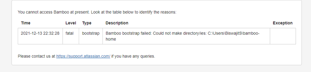

Biswajit Sahu December 13, 2021
Hi Daniel,
I go through your link, I setup my users in my local, but still got same issue,Bamboo.PNG
I am using Version 8.0.5, I have tried alsot. Please help me on this.
Biswajit

Devendar Gangapuram
January 2, 2024
Hi @Daniel Ebers ,
For me everything was fine, I was able to set up BAMBOO as service and I could make stop/start using this service. But suddenly today, it was giving this "fatal" error  as Biswajit posted.
Please help me on this, as it is blocking our further work
