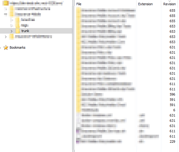

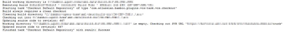

Looking at the logs after the job completes, I see it checking out \trunk but then it lists the revision number as something like 667 (or the latest rev from a branch), when the latest revision committed to the trunk would be 655.

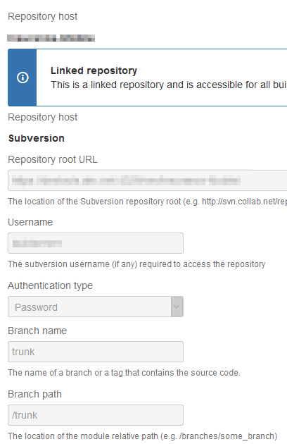

See photos for the config of the repo (which is used by other projects without any of these issues) and the revision named in the build logs vs the actual latest branch revision.

Its a limitation in Bamboo. It only checkout the global repo revision.
Feature request https://jira.atlassian.com/browse/BAM-10396
