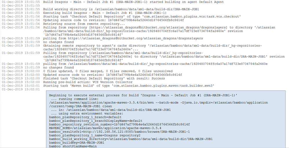

I'm doing the dragon slayer quest. I'm at the end of step 8 where i have to run a job with bamboo.
When i run the job, it's failing. I'm not able to find the reason even with the log file (i'm noob)
Can someone help me ? I give you the log
Thanks !

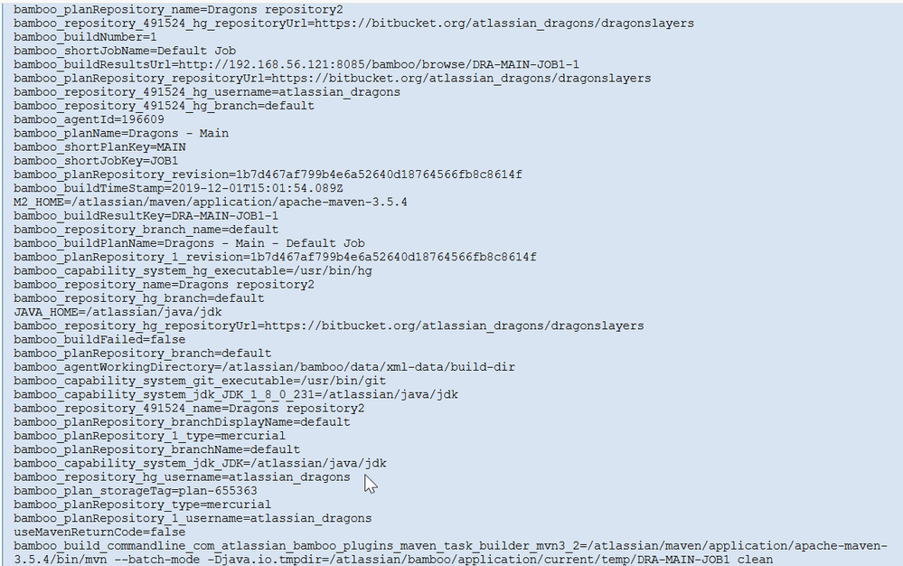

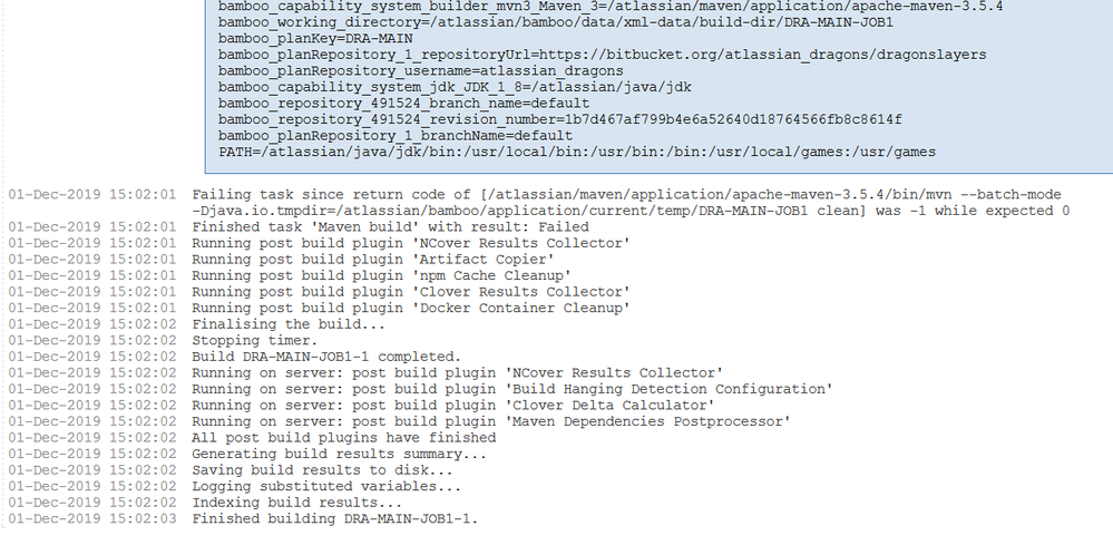

2019-12-01 16_11_49-Dragons - Main - Default Job 1_ Build log - Atlassian Bamboo.png2019-12-01 16_12_23-Dragons - Main - Default Job 1_ Build log - Atlassian Bamboo.png2019-12-01 16_12_51-Dragons - Main - Default Job 1_ Build log - Atlassian Bamboo.png

Hi @Cyril Velia,
What operating system is the Agent that is building this task running on?
Whenever I have seen this it's usually because it can't find the executable (maven in this case).
On windows specifically there was a bug where user defined environment variables would override the system defined ones causing the exact symptoms you are seeing, but that has been fixed in version 6.10.2

Hi!
In the log you can see maven --batch-mode returned -1  instead of 0 ./
