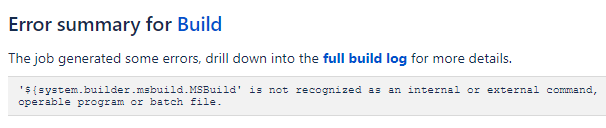

It looks like the error is that the ${system.builder.msbuild.MSBuild v14.0 (32bit)} variable isn't being changed to the executable path in the build log's error file:
I've tried to escape the spaces with single/double backslashes (documentation here), but I still get the same error, just with an added backslash after msbuild.MSBuild.

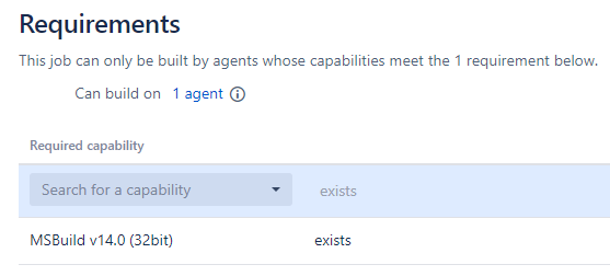

The agent capability does show up in the stage's requirements, so I'm not quite sure what I'm missing in the script entry.
