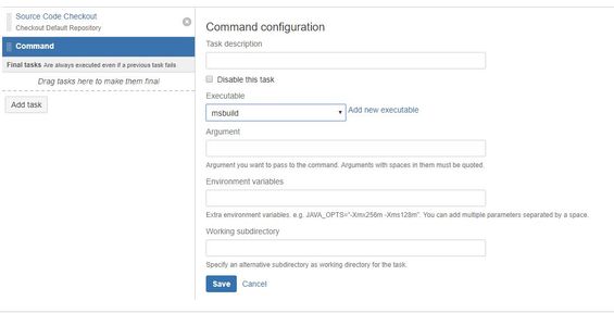

If you are trying to call/execute a *.exe file that is installed on an agent machine have you tried adding it as a "Server capabilities" for local agents, or to the "Capabilities" tab on a remote agent?
From there you should be able to add a "Command" task in your Build Plan or Deployment Project that can call that executable with the parameters that you wish to execute.

@Jimmy Seddon thanks for the prompt response. This was a different approach than I was thinking. Let me see if I can work this out.
