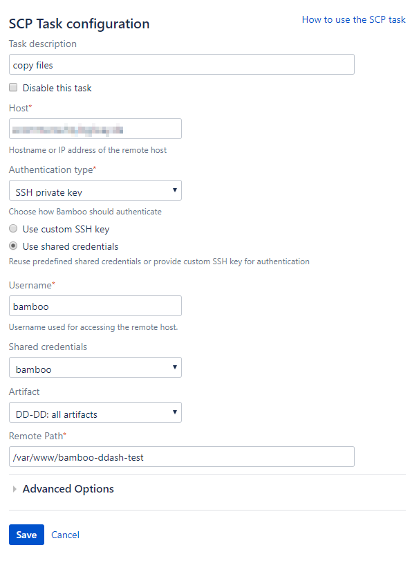

I'm setting up Bamboo for the first time.
I did a successful build and then wanted to do a deploy, including an SCP task.
I get the error message "Error occurred while running Task 'copy files(3)' of type com.atlassian.bamboo.plugins.bamboo-scp-plugin:scptask." (See full log below).
Currently I have no idea what the issue might be.
The SSH credentials work as an SSH task in the same job (ls -lsah) completes successfully.
The task config looks like this:
I installed Bamboo on my Windows 10 machine for testing purposes. I didn't install any extra software so far, outside from Bamboo and adding JAVA_HOME to my PATH to make it run in the first place.
I'm running start-bamboo.bat in an administrator shell
Full Log

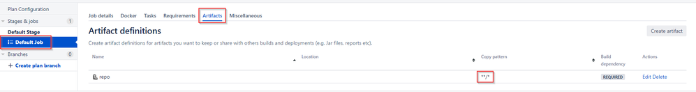

The error cause seemed to be, that no artifact was configured in my Build plan -> Default Job.
I added an artifact simply with the pattern "**/*", which clones all files from the working directory, except CVS folders by default.
2019-05-09 16_08_40-DDash2 - DDash2 - Default Job_ Edit job configuration - Atlassian Bamboo.png
