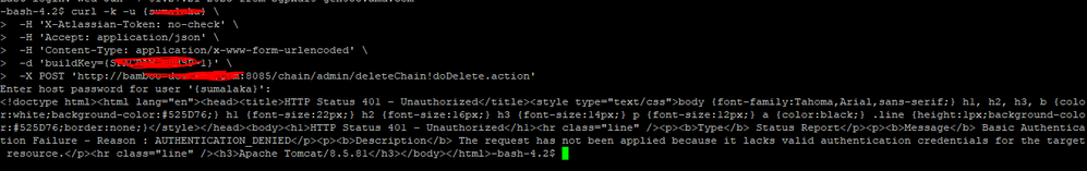

@SunadhRaj.Malaka As from screenshot, you are getting 401 error. Please check if credentials are fine or also, please check below:
You can also follow this doc : https://confluence.atlassian.com/bamkb/how-to-delete-bamboo-projects-and-plans-in-bulk-using-rest-api-1216583450.html
You be honest, I am not sure about Rest API's. Might be above solutions will help you or you can also raise the ticket with Atlassian via https://support.atlassian.com/

i want to delete from REST API , i am trying with this below rest api and facing some the issue attached can you guide me on this .
REET API
# Marks plan for deletion. Plan will be deleted by batch job.
# replace {username}
# replace {planKey}, e.g PROJ-PLAN
# replace http://localhost:8085 with URL to access Bamboo
curl -k -u {username} \
-H 'X-Atlassian-Token: no-check' \
-H 'Accept: application/json' \
-H 'Content-Type: application/x-www-form-urlencoded' \
-d 'buildKey={planKey}' \
-X POST 'http://localhost:8085/chain/admin/deleteChain!doDelete.action'2
error is attached
