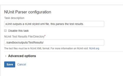

I took a look at my own environment and realized that we aren't acutually using the MSTest Parser task.  I'm using the NUnit Parser task who's configuration looks like this:
I hope one of those two options helps you resolve your issue.
