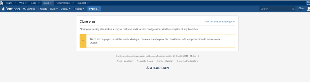

When I am trying to clone the master plan, here is the error that I am getting. how do I resolve this?

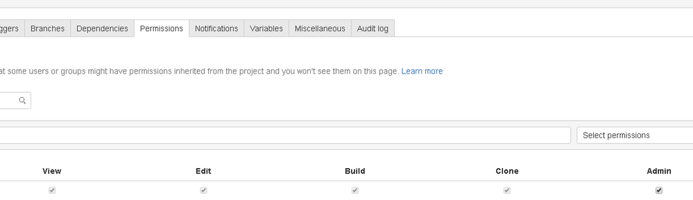

Also, The permissions tab does show that I have permission to clone the plan.

The missing permission is in the Project side.
The Project Admin will need to add Create Plan permission for you at Project settings (for the related project) > Project permissions

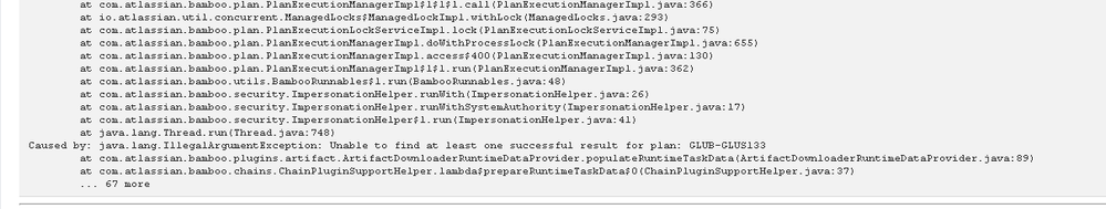

However, when I try to run the branch form the plan that has the "Artifact download configuration" task, I receive the following error. Any suggestions please?
Never mind. I had to run my default branch again to straighten out some issues there. After that the new cloned branch works fine and the artifacts are shared perfectly.
