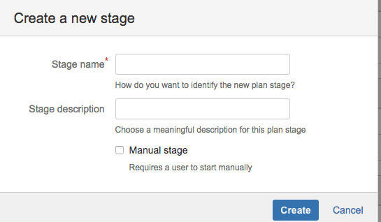

This is on my mind right now, We have 2 Stage&Job on the build plan the 1st stage will run on the plan branches and the 2nd stage will run only on a  specific branch like (develop). Is that possible? Because if you try to create a stage there are no settings that will run in a specific branch. Our bamboo version is v6.2.2
Your insights will be much appreciated.
Adrian

Hi Adrian,
I can think of a workaround to make the stage as a "manual" stage so this way you can run the stages wherever and whenever you want to run. But, the limitation is that you will have to do it manually.
Thanks.

Hi Robhit,
Breaks my heart to hear that. Thank you for the response. I'll consider this as an answer since this is already applied on our stages.
