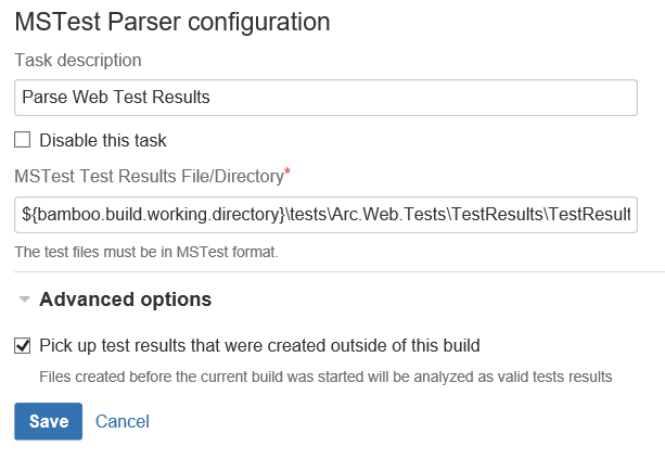

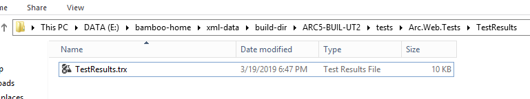

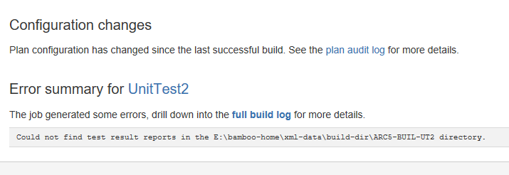

I set up an MSTest Parser Configuration in Bamboo like this: ${bamboo.build.working.directory}\tests\TestResults.trx. When running Bamboo doesn't resolve this. It only replaces $${bamboo.build.working.directory}, but does not append \tests\TestResults.trx and therefore cannot find the .trx file. Note: the .trx file is being created properly.
What am I doing wrong?

  4. Please share the full error you see in the build logs.
Ariel R. Conti March 19, 2019
The file exists. Bamboo doesn't find it because Bamboo isn't resolving the directory.
