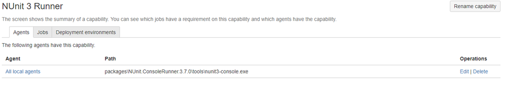

The console runner executable is located in the packages folder of my .NET project and if I dive into the checkout directory on the build server the .exe is in packages\NUnit.ConsoleRunner.3.7.0\tools\nunit3-console.exe which is where I have Bamboo looking for the executable:

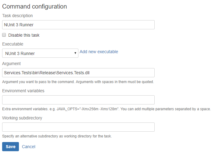

And in the build plan I have the following in the Command task:
