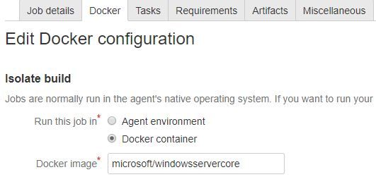

I am trying to run build plan on a windows docker container instead of directly on windows agent itself.
For some reason bamboo tries to start docker container with "--net host" mode and since windows container doesn't support this mode, it is failing. I need to find a way to prevent bamboo from using host mode, but I am not finding any configuration in my bamboo server.
Bamboo is trying to start container like following:
C:\Program Files\Docker\Docker\Resources\bin\docker.exe run --volume C:\Users\Administrator\bamboo-agent-home\xml-data\build-dir\PAN-PAND-JOB1:C:\Users\Administrator\bamboo-agent-home\xml-data\build-dir\PAN-PAND-JOB1 --volume C:\Users\Administrator\bamboo-agent-home\temp:C:\Users\Administrator\bamboo-agent-home\temp --detach --name 0eed3b21-3a3c-41e8-8e1b-1551be98f9c993388925 --net=host microsoft/windowsservercore tail -f /dev/null
... in: C:\Users\Administrator\bamboo-agent-home\xml-data\build-dir\PAN-PAND-JOB1
