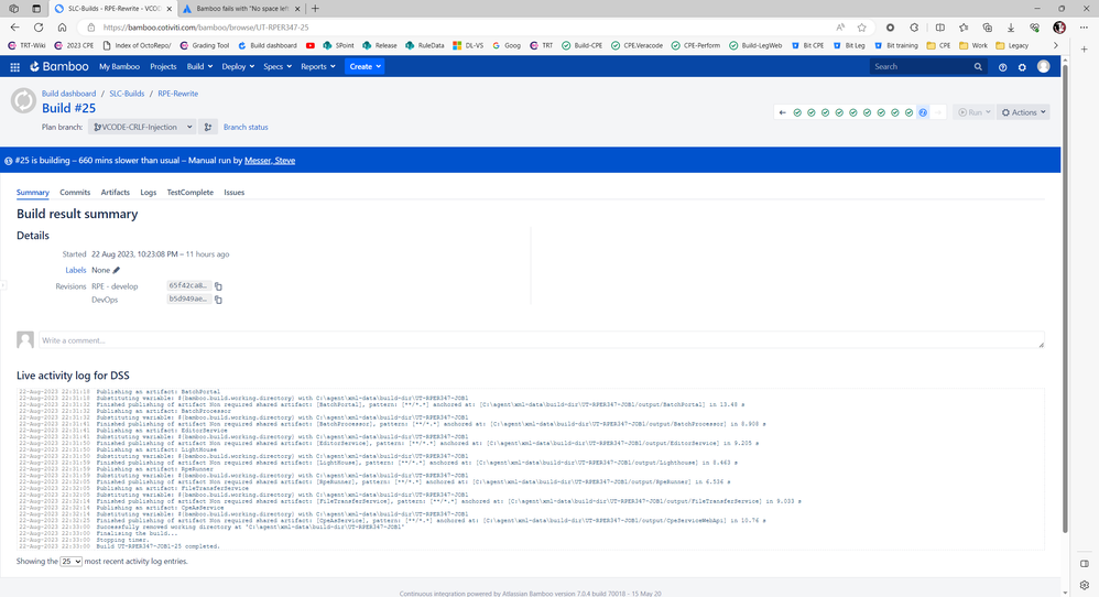

For the past 2 or 3 weeks we have been seeing build issues.
In the Web UI it just says building slower than usually and hangs indefinitely.

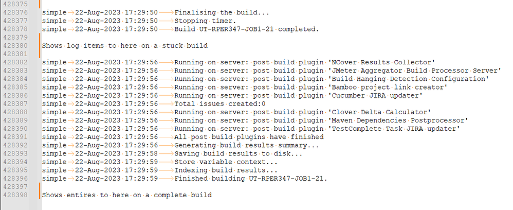

When a build fails the logs show the following three entries:
  simple 22-Aug-2023 17:29:50 Finalising the build...
  simple 22-Aug-2023 17:29:50 Stopping timer.
  simple 22-Aug-2023 17:29:50 Build UT-RPER347-JOB1-21 completed.
When a build succeeds the logs show the following after these three lines
simple 22-Aug-2023 17:29:56 Running on server: post build plugin 'NCover Results Collector'
simple 22-Aug-2023 17:29:56 Running on server: post build plugin 'JMeter Aggregator Build Processor Server'
simple 22-Aug-2023 17:29:56 Running on server: post build plugin 'Build Hanging Detection Configuration'
simple 22-Aug-2023 17:29:56 Running on server: post build plugin 'Bamboo project link creator'
simple 22-Aug-2023 17:29:56 Running on server: post build plugin 'Cucumber JIRA updater'
simple 22-Aug-2023 17:29:56 Total issues created:0
simple 22-Aug-2023 17:29:56 Running on server: post build plugin 'Clover Delta Calculator'
simple 22-Aug-2023 17:29:56 Running on server: post build plugin 'Maven Dependencies Postprocessor'
simple 22-Aug-2023 17:29:56 Running on server: post build plugin 'TestComplete Task JIRA updater'
simple 22-Aug-2023 17:29:56 All post build plugins have finished
simple 22-Aug-2023 17:29:56 Generating build results summary...
simple 22-Aug-2023 17:29:58 Saving build results to disk...
simple 22-Aug-2023 17:29:59 Store variable context...
simple 22-Aug-2023 17:29:59 Indexing build results...
simple 22-Aug-2023 17:29:59 Finished building UT-RPER347-JOB1-21.
