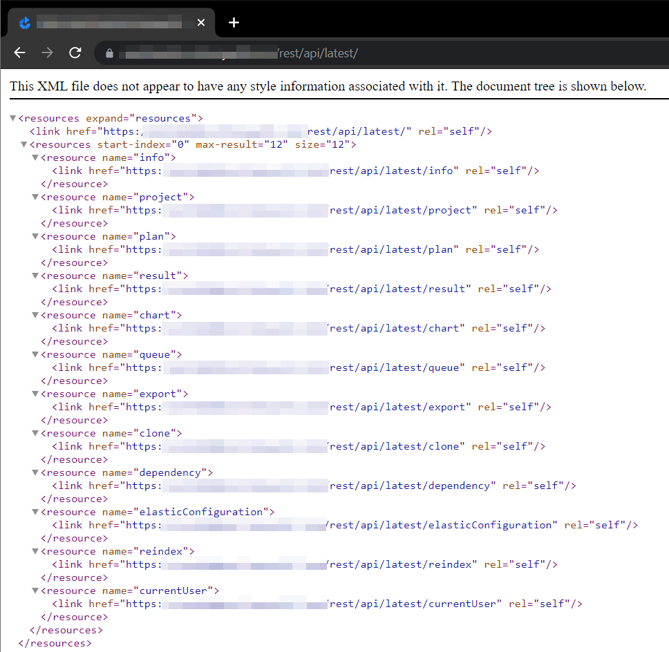

I can confirm that other REST API endpoints work to some degree:

Thanks Hyrum for the response.
I can confirm that my credentials are not an issue, as other REST endpoints (including ones that require my specific user's permissions to view) function correctly within the same session, and when run from an alternate tool (different browser, and using cURL).
Please note that the error code is a 403, not a 401. I confirmed the status code presented in the browser matches the status code sent in the header:
