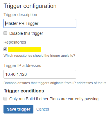

I'm new to bamboo and webhooks. I'm trying to start a bamboo build automatically when a PR to master branch from my repo is opened.
I followed this guide but the remote trigger is not starting at all.

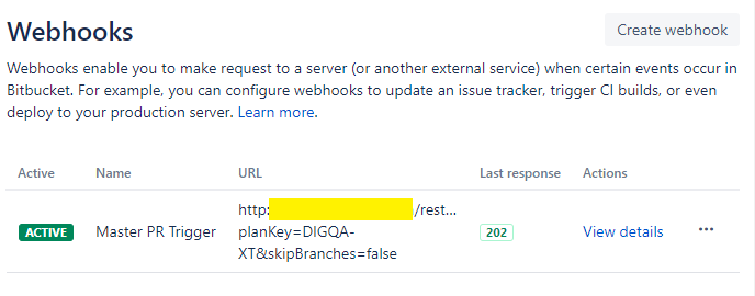

BitBucket:
I've already checked the following:
- verify that the whitelisted ip is correct (the bitbucket webhook fails if i remove that)

- name: Remote trigger
description: Master PR Trigger
pluginKey: com.atlassian.bamboo.triggers.atlassian-bamboo-triggers:remote
enabled: true
configuration:
repository.change.trigger.triggerIpAddress: 10.40.1.120
triggerConditions:
com.atlassian.bamboo.triggercondition.internal:plansGreenCondition:
enabled: 'false'
triggeringRepositories:
- 7818811903068661169

For the Webhooks in Bitbucket Cloud repository, is the option "Choose from a full list of triggers" selected so that it can be configured to trigger when Pull Request Created?

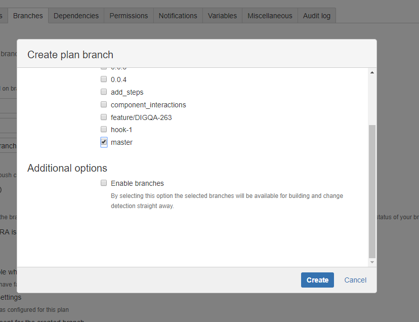

Since the commit exist in the repository branch, is the branch plan created at Bamboo Plan Configuration >> Branches so that it can run build with the related repository branch?
-- No, and i dont see that option either. but the Pull Request event is already selected; Meaning, the webhook is fired successfully upon opening a PR
-- Yes. The plan branch is already created.

Just notice the screen shot that it is Bitbucket Server instead of Bitbucket Cloud. For Bitbucket Server, there is no need to create any Webhook. Bitbucket Server will trigger Bamboo by default if Application Link is created between both servers.

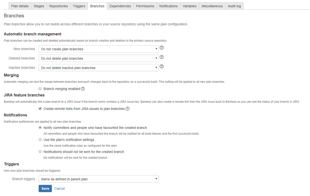

When the branch plan is created in Bamboo, did it run for the first time? Automatic Branch creation can be configured at Plan Configuration > Branches to create branch plan when the PR is created (it will be triggered to build immediately too).
I created the branch plan manually and tested that it builds fine by running it manually and automatically by merging the PR. The real missing bit is run it when the PR is opened.

I used remote trigger as a workaround because I'm getting some sort of proxy issue when I use the bitbucket server trigger (bitbucket webhook request fails upon opening a PR). Will this be an issue with the setup I'm trying to do?
There is no need to use Bitbucket Webhook as well when using Bitbucket Server repository triggered. Bitbucket Server will still trigger Bamboo without the webhook if the Application Link is created.

If the option When pull request is created is selected at Bamboo Plan Configuration > Branches > Create plan branch , the above trigger event will automatically create a branch plan and build for the first time.

Select the option When pull request is created at Bamboo Plan Configuration > Branches > Create plan branch

Hi, I don't see the "When pull request is created" at the create plan branch screen.
This is the bamboo version we're using:
Version 5.14.3.1
Build number 51416
Build date 12/5/16
Also, I confirmed that the link between bitbucket and bamboo is already configured.
Is there anything I'm missing?
Thanks!
Version 5.14.3.1
Its a new feature in Bamboo 6.0+
Based on your use case, Bamboo need to be upgraded to 6.0+ so that it can be configured with this new feature.
