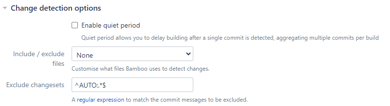

Next I tried setting an "Exclude changesets" pattern on the Linked Repository:Bamboo - Linked Repo - Failing exclusion.png
This was a partial success in that it didn't trigger a build, but it did trigger a plan change (my .version file is in the bamboo-specs folder)
I presume this partial success indicates that the regex is working, but the behavious is not as I'd expect. I tried a few variations just in case, same result for each.
AUTO:.*
^AUTO:.*
^AUTO:.*$

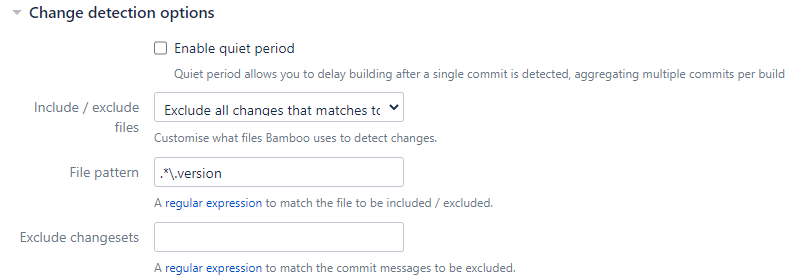

Finally I tried settings an "Exclude files" pattern. Same as above - the spec configuration is updated but a build does't trigger.
