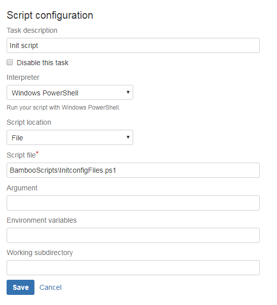

I then call my Init script like this:BambooScript.PNG
This work perfectly fine when I run the agent manually in a terminal but when it is run as a service then the script return -1 directly, the first line of the script isn't even run. I know that the script work as again it work fine when the agent  is ran manually.
