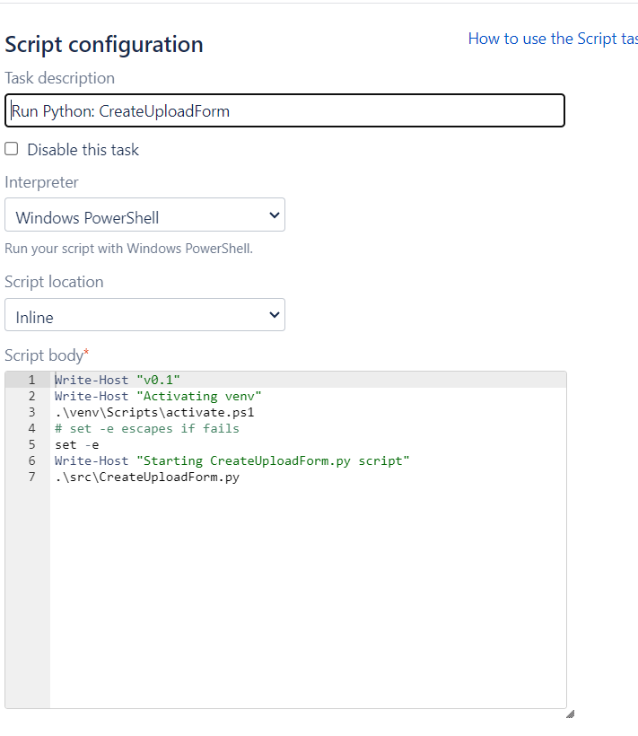

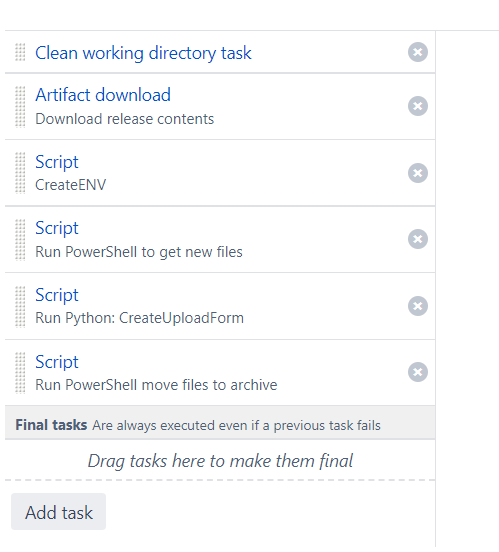

Below is my current bamboo task list.
What I am looking to do is, if the script that runs python throws an exception, the powershell after it does not run.
According to bamboo, despite the exception being thrown, the script ran "successfully' and it continues running the powershell script.
I should mention that my bamboo servers are windows, not linux if that matters.
Where do I add the -e?
Is it here?
Thanks again!

Hello Billy,
Thanks for providing the clarification regarding the structure of your Job, now my understanding is clear.
Basically you have 1 task which is Python script and if this Task fails, you don't want another Task which is Powershell script to be executed.
In your case somehow Bamboo is returning exit code as 0, hence marking your Python script task as success.
set -e option will not work here as it is for Linux and your scripts are getting executed in Powershell environment.
I am not an expert in Windows shell programming, you can try couple of Options.
Option 1:
You'll need to exit with the exit code if it's non zero manually, you can try something
if ($lastexitcode -ne 0) { exit $lastexitcode }
Option 2:
You can try the below
echo "Exiting with return code: " %ERRORLEVEL%
exit %ERRORLEVEL%
 You can read more about these at
https://community.atlassian.com/t5/Bamboo-questions/How-do-you-capture-a-task-error-during-a-build/qaq-p/1238630
https://stackoverflow.com/questions/15777492/why-are-my-powershell-exit-codes-always-0
