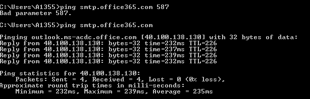

Manish Sharma November 17, 2017
Hi Robhit
Thanks for your reply.
Tried running a ping command on our AWS server and got successfully message.
ping smtp.office.365.com 587  >> It threw error that 587 is bad parameter
ping smtp.office.365.com 587  >> it successfully pinged.
Pls suggest

robhit
November 17, 2017
Hi Manish,
There is a difference between Ping and telnet.
In short:
Ping: check connection (knock on the door of the remote server).
Telnet: gives access to the remote system if it is running telnet daemon.
And while using port 587 ping throws the error because it does not support that parameter.
Try executing the telnet command which I shared earlier. This will test the connectivity between your bamboo machine and the SMTP server if the port 587 which you are using is correct or open or not
