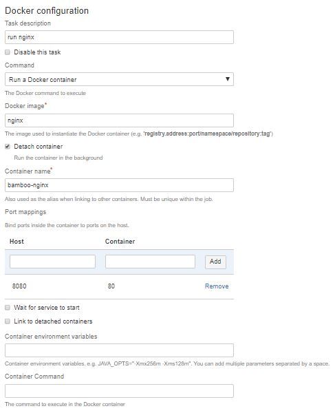

I'm using the docker plugin to run a "docker run" by Bamboo with the settings below.

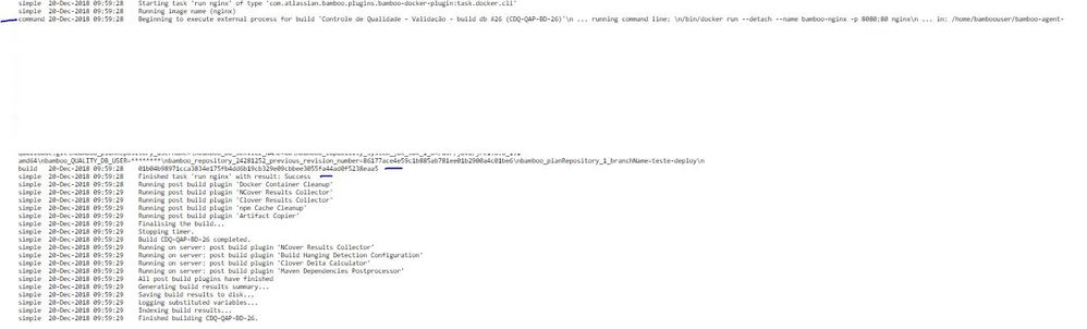

my log is this
The problem I'm facing is that according to the documentation the "Detach container" option should keep the container running in  background (https://confluence.atlassian.com/bamboo0603/configuring-the-docker-task-in-bamboo-939491356.html#ConfiguringtheDockertaskinBamboo-run), but the behavior is different.

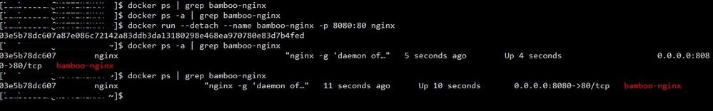

You can see in the photo below that the container is created but it is destroyed at the end of the terefa. It is also possible to see that I executed the same command generated by the plugin and the container in this case is still online.
Anyone have any idea what might be happening?
